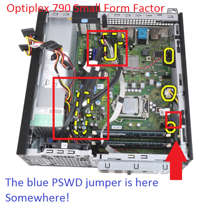

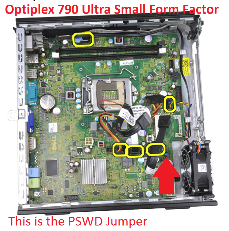

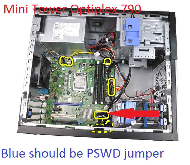

There should be a PSWD jumper on the motherboard.
Pull the jumper then with the jumper removed, power on the system... you will hear a couple of beeps and it will say something like "Password Cleared" on the screen.
Turn it off and replace the jumper.
Here are the Password Jumpers (PSWD). They are pretty much always BLUE on most newer OptiPlex systems.

Pulling the PSWD jumper and turning it on caused the following message:
Password Disabled!
Press F1 to continue. Press F2 to enter setup.
I pressed F2 and it showed the Admin/System password as NOT SET and that the jumper must be replaced before one can be set.
... I replaced the jumper and effectively cleared a test password.
