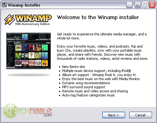

The next installer screen just lists the features of the newest Winamp version and we can just press the Next button by pressing ENTER to bypass this:
WinWaitActive("Winamp Installer")
Send("{ENTER}")

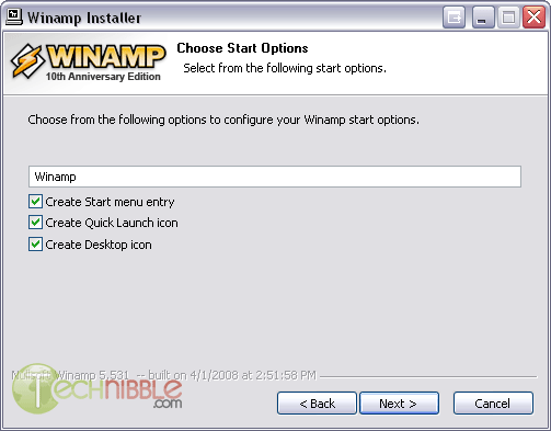

The next page allows us to choose some start options, once again I will be leaving this is default and pressing Next.
WinWaitActive("Winamp Installer", "Choose Start Options")
Send("{ENTER}")

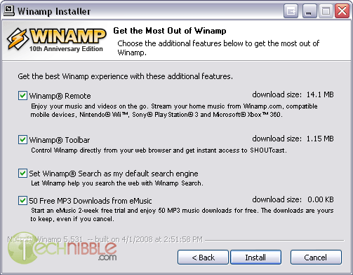

Now we are onto Winamp’s “Additional Features”. I don’t know about you but I hate these options because it installs a toolbar, changes your search provider and places an advertisement icon on your desktop, so I will be deselecting all of these.
Remember how I said to imagine that you don’t have a mouse? As you probably know the way to cycle through the options in an application is to press TAB.
So I need to press TAB once which will move the selector to the Cancel Button. Press it again to be on the “Winamp Remote” option and then press SPACE to deselect it.
Then press TAB again to get to the next one and press SPACE to deselect the Winamp Toolbar. I do this twice more to Deselect the Search option and the 50 free Mp3s option.
I press TAB again which takes me to the Back button and press TAB once more to get to the Install button. Once I am on the Install button I press ENTER.
WinWaitActive("Winamp Installer", "Get the Most Out of Winamp")
Send("{TAB}{TAB}{SPACE}{TAB}{SPACE}{TAB}{SPACE}{TAB}{SPACE}{ENTER}")

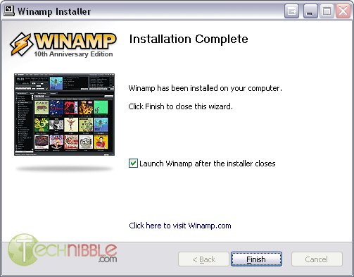

Now we have one last option left, the “Launch Winamp after the installer closes” option. Since this article is about unattended installs, I am going to deselect it and press Finish:
WinWaitActive("Winamp Installer", "Installation Complete")
Send("{TAB}{SPACE}{ENTER}")
