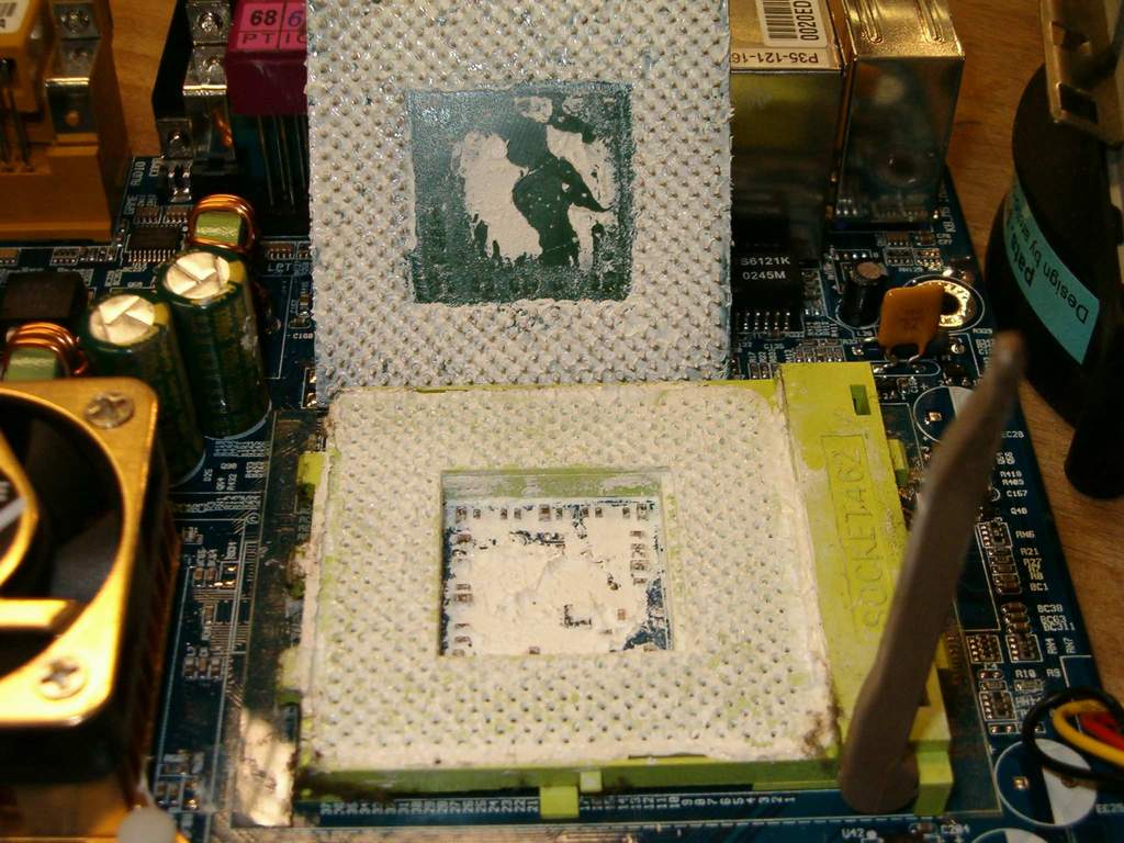

Just make sure to put the thermal paste on the top side of the processor unlike this.
Though, we later determined that it was phase change cooling which kind of killed the fun :(
Wow - I haven't laughed that hard for ages..:D
