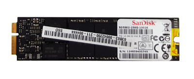

Sandisk:
I mean, it could be that drive for sure... 1Q 2014 - and it's one of those 'half-sized' ones... usually only OEM's that go for that. 2014 was still pretty early in the SSD game. Wouldn't surprise me to see it failed if that's what it is.
