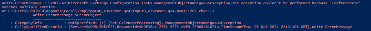

When I try to change delegate access to automatic in powershell I get the error
When I try to add a room delegate to the room I get the same error message
Any ideas?

I think I found a reference to a mailbox that uses conference10 as an alias in Entra in addition to my room... I'm going to try changing that and give it a day or so for the changes to take effect to see if that changes anything.

Their boots on the ground IT guy (who has since been fired, I'm the background MSP), created a licensed mailbox called Conference (Unit 10) and Conference (Unit 8) and manually (L O L) shared it out to each user (40 total) using delegate full control for the entire mailbox.
Conference (Unit 8) uses the mailbox conference@contoso.com
Conference (Unit 10) uses the mailbox conference10@contoso.com
My room is Conference10 with the mailbox conference.10@contoso.com
So that's what I'm guessing the discrepancy is. If I define conference.10@contoso.com in powershell to add a delegate approval reponder to the room instead of just Conference10 it actually works and the delegate gets added but I don't know how to switch the bubble from Auto-Approval for room reservations to "Select room delegates for approval" in powershell... I haven't been able to find that command. It adds the selected delegate to the list but creates a new bubble called "Used customized setting to accept or decline booking requests"
I renamed both Conference (Unit 8) and Conference (Unit 10) to conferencerm8@contoso.com and conferencerm10@contoso.com respectively.

Realistically both of those licensed mailboxes should be deleted as they were created as licensed mailboxes with the intent to only use the calendar part of the mailbox as a shared calendar for what is essentially should have been a room resource.
