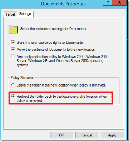

What I prefer to do is to move them in batches, first set the GPO that's doing the redirecting to revert the settings when it isn't applied. Once that's sunk in, I move the users out of that OU, reset their passwords and login as them on their stations. That moves the files off the server to the stations as if they're default profiles. Once that's done, the OneDrive Backup can be enabled.

Yup we do that a lot. Generally it's controlled by group policy, so...like Rob said above....tickle that setting to ensure it reverts back to local when removed...make sure it settles in...either disable it later...or move the users out of the OU....and ensure after a couple of reboots that the files went back to the local C:\Users\Username\Folders
You'll know when it kicks in..that next login may take a while as the folders get pushed back to the workstation.

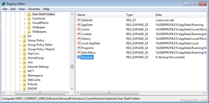

You can manually manage that via the registry, I've fired up the registry..(see following link)..and manually set the Docs/Pics/Desktop...course you have to go copy the users files from the redirect folder on the server..put 'em here after you've made them. But it works on those rigs that for some reason never listened to the squashing of the folder redirect GPO.
