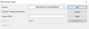

When attempting to run the program I get this error:
Followed by:
I took the laptop onsite and the issue did not change.

Looks to me like you are trying to use windows authentication. Can you add a user to SQL server and login with that?
The product support is being stupid, the VPN has nothing to do with this. A non-domain member machine isn't capable of logging into the database using the same credentials as other systems. It simply needs updated.
Locating the DC is equally irrelevant, because the laptop isn't a domain machine!
Call those yahoos back and specifically ask them where in their application they configure the SQL connection string. Then configure it with an account that works. Don't know one? MAKE ONE!
