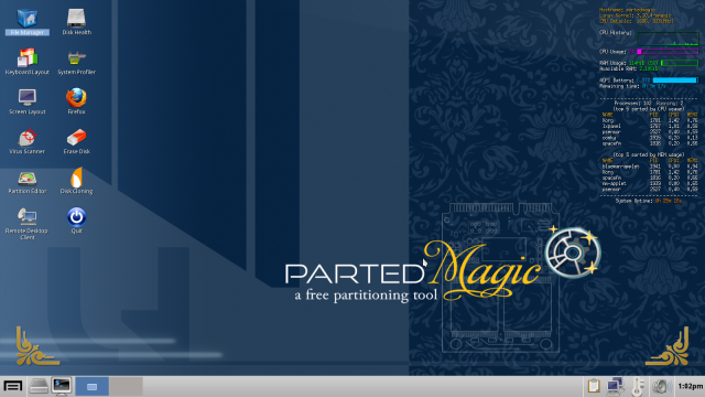

Boot Pmagic via you preferred method, and you'll be presented with this desktop:
Usually, the first thing I do is plug in a thumb drive and mount it (use the disk icon in the taskbar), so that I can store any reports or screenshots during the process.

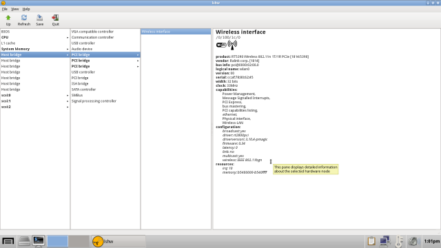

Next, I'll generate a list of all of the current hardware (the linux kernel is very good at recognizing most hardware). In the “Start Menu” go to System Tools > LSHW, and refresh the list after it opens. Browse the hardware if you like, then click Save, and save the information to your flash drive as a text file (or alternate format if you prefer). Here's a sample of what you get: https://docs.google.com/file/d/0B9IE7KXr0pJyQ1V4NE1ZbVkxOTQ/edit
Close application when finished.

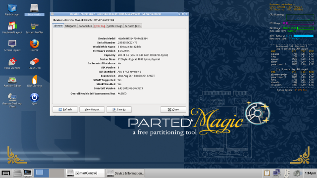

I then fire up GSmartControl (the Disk Health icon on the Desktop) to check the hard disk. After selecting the appropriate drive, I look for red or pink shaded tabs indicating potential issues and perform the standard short and extended self tests.

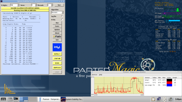

Finally, it's stress test time. Pmagic includes a program called System Stability Tester (System Tools > System Stability Tester). SST uses various algorithms to calculate pi up to 128 million digits. From the tool's website:
System Stability Tester tries to test the system's stability by calculating up to 128 millions of Pi digits. It supports multiple calculation algorithms. For the moment only two have been implemented. The*Quadratic Convergence of Borwein*and*Gauss-Legendre, the algorithm*SuperPi*uses. The testing process includes the creation of two or more threads. After each step of the calculation, the results of all the threads are compared. Any differences between them are reported. There is also the option for single threaded calculation, but in this case there is no stability check. This is useful for benchmarking purposes only. The calculation of Pi itself is multi threaded since version 0.7.2, for the Borwein algorithm only.*
Generally, I select options that will get the machine “breathing hard” for several minutes. You'll get a feel for this (# of digits, turns, and threads) after a while. I usually select the number of threads to match the number of cpu cores.
Here is where the previously mentioned temp monitor comes in. Temperatures will rise quickly. I keep an eye on them for any obvious problems, but what I'm really interested in is how fast the temps go down after the stress test. This is true especially for laptops, where it might be more difficult to determine how well the cooling system is working.
