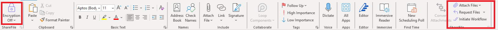

Alright so I dug into this and it really seems about as easy as it could be (in my eyes) with the Sharefile Outlook plugin. The pricing seems like we have to go with at a minimum the $75 per month option for HIPAA.
What makes the premium version HIPAA compliant? Is automatically HIPAA compliant just by using that license?
Also wondering if you have experience using it yourself?
In Outlook there is the option to attach a file using the Sharefile plugin and as far as I am aware attached files are always encrypted and the client is ALWAYS required to create a Sharefile account to access them. There is also the option to encrypt the email itself so even the body of the email requires you to login to Sharefile.
When they are sending encrypted docs should the entirety of the email be encrypted? Body and attachment's to fulfill HIPAA?
I can echo the suggestion for ShareFile. I can configure SharePoint to do all of this, but it's a TON of work. Not worth it for smaller orgs to reinvent the wheel in such a way.
