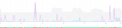

Client was complaining that their internet was intermittently dropping. I started troubleshooting and when sifting to logs I was seeing that their DVR was getting pummeled due to the open ports. Every time their internet cut out the DVR uploaded a massive amount of data which shut them down. See the graph below:
All purple spikes are the DVR sending data and then the internet drops hence the red outage.
