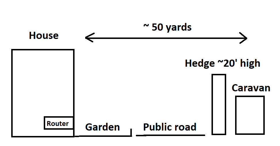

Customer wants to extend wifi from the router in his home to his caravan which is parked in a field 50 yards away over the road. There is a garden, a public road, and a tall thick hedge separating the house and caravan. I'm no Picasso but a rough layout is below. Electricity to the caravan does not come from the house so homeplugs are not an option. I'm not sure a mesh setup would extend that far but I haven't tested it. This type of situation is new to me - anyone have any ideas? Would like to think I don't have to just suggest a mobile broadband contract to him. Thanks.

If you want a guaranteed, rock solid, connection either the hedge needs to go or you need a pole to raise above it. Anything else is going in the "it might work, it might not" category. Even if the connection is stable at installation what about in rain, high winds etc. Also, due to the public road I'm assuming the customer does not own/maintain this hedge. What if nobody trims it for the next 2 years.
I would look at having a 3x3 fence post fitted next to the van and fix a pole to that. Shouldn't be expensive at all.
I used to run a little wireless internet system for myself and a dozen or so neighbors. I found 2 ways to reliably go through living vegetation: Circular-polarized antennas, and radios that use multiple antennas and sophisticated signal processing. This was back in Wireless-N days, but I would hope the newer standards would be at least as good at it. One of my main backhaul links went 2 miles through the top 1/4's of 12-15 large pine trees using CP antennas at both ends. I had several links going through thick vegetation using either CP at one end and MIMO at the other, or MIMO at both ends.
I think the road will be the bigger problem. If you don't want the signal to hiccup every time a car goes by, you'll have to keep it above the traffic.

I'd use the small Ubiquiti airMAX units like the Nanos.....very inexpensive, put a pair on each end, facing each other. 1x row of hedges will not impact it much. To improve things, "thin" an area of these hedges so the "fresnel zone" has a thinner area to punch through. But even 5.0 models will be OK through a little foliage, esp at this close distance. Only thing I might worry about, depending on these hedges, I see you're in the UK so we have winter to deal with, very thick snow accumulating..possibly semi freezing into thick crunchy icy snow/ice...impacting the signal a bit. So...better option, raise the height for those nanos...up on poles. And then put an AP on the receiving end behind the nano. You also have that new Unifi building to building bridge kit...it's basically Unifis version of airMax.
