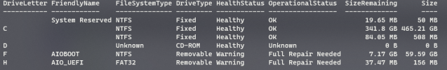

I did some searching and it seems that Offline flag doesn't do the prompt for a reboot like chkdsk does if the volume can't be taken offline.
When I run Repair-Volume -DriveLetter C -OfflineScanAndFix, it had a little progress bar but quickly went to No Errors Found. I'm assuming this went so quick since all my volumes are Healthy according to Get-Volume
So I plugged in my flash drive, which is dirty. It actually took maybe 30 seconds, and now both volumes on it are healthy.
If you a looking for a full offline scan like on reboot, I think you have to stick with chkdsk.
