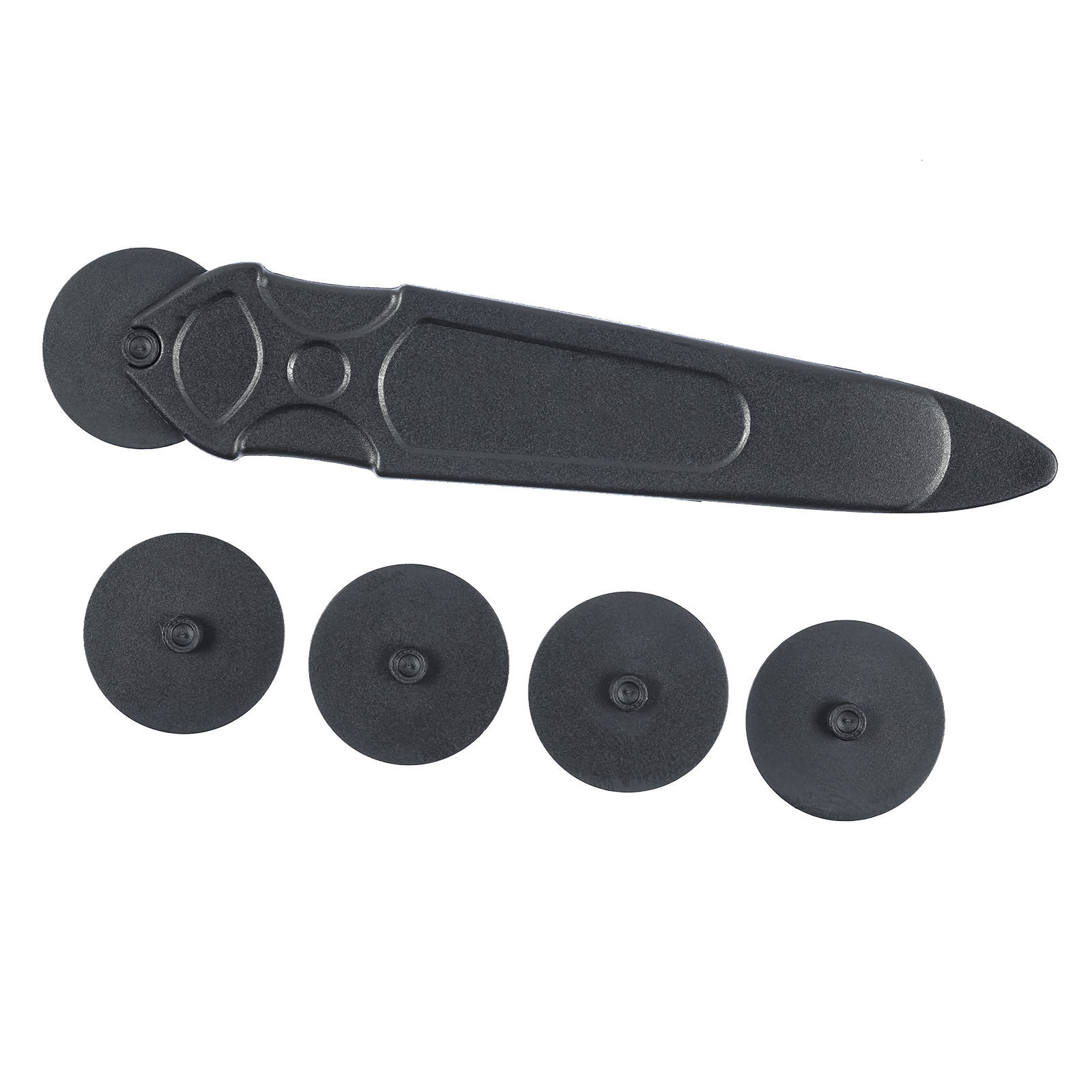

The iMac original VHB strips are fairly easy to remove, I just use a black stick to peal the tip and pull them away, (after separating the display from the housing of course) if the VHB are not from apple (ifixit, owc etc..) those are a PITA and you WILL loose a lot of time removing those...
for a oppening tool use this

For opening / removing the screen I use the pizza cutter that @overburnz pictured above. I did break out the heat gun after the screen was removed to try to help with cleanup, but it wasn't too helpful. Mostly I used my thumb and rolled and bunched up the adhesive.

There are two types of adhesive and two types of pizza cutter, you need to be careful which ones you buy. Buy the official Apple kit, the adhesive strips have a foam core and are easy to remove again if you need to, once the screen is off the remaining adhesive peels off with ease the cutter blade is very thin. The Apple part numbers are 076-00331 for the 21.5" kit and 076-00332 for the 27" kit.
If you buy the unofficial adhesive strips they don't have a foam core and are a nightmare to cut without cracking the screen and once you have got the screen off it takes forever to remove the remaining adhesive. The unofficial cutters have a thicker blade and if you're not careful and push it right in straight away the screen will crack, a costly mistake! It's just not worth using non-official strips and cutters.
