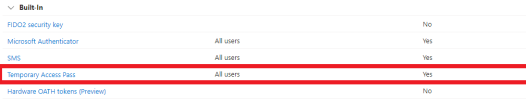

Add delegation for the mailbox to your account or the owners account and go and delete it. Or create a TAP password for the account with a 1 hour expiration and go check if it's unread and delete it.
Also this
