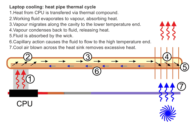

Check the heat pipe (the copper tube you refer to).
It's most likely bad, any cracks or odd bulges?
Heat pipe is what actually does the cooling.
Heat pipe looks to be in good condition. I've not come across a bad heat pipe that I am aware of.
Is heat getting to the fins of the radiator? (Temp at fins?) It sounds like the heat pipe has dried out.
Hard to get a good reading on the radiator as this model uses the rear casing as ducting to channel the air from the fan through the fins, so when the case is off the fan is pretty much useless. However, the air exiting the fins should be hotter than it is (in my experience) and I am starting to think the problem may be caused by poor connection between the heat pipe & radiator. I did not know heat pipes have fluid in them! Learn something new every day...

Thanks to your excellent explanation of how the heat pipe works, I can see that the heat pipe appears to be working at least up to the point where it changes from copper to black...paint? (where the heatsink is attached).
