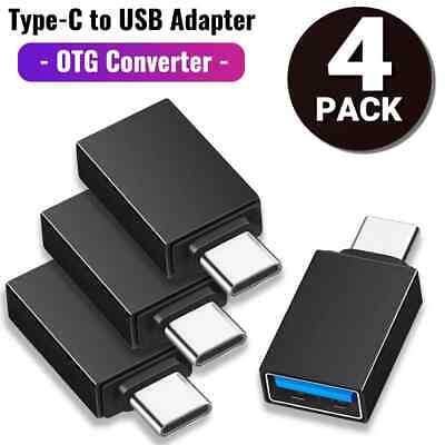

Well in the end I purchased an adaptor for the purpose, always shy of them though this one worked fine.
USB-C TO Friggen USB-A Adaptor
I've bought quite a few of these simply because USB-C is becoming the default on most laptops and there's still an awful lot of USB-A equipment out there. Never had a single issue with them, either.

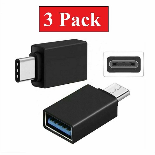

and an even better deal:
These adapters are not "rocket science."
