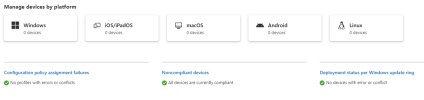

New tenant, devices wont register with Organization (Business Premium).
thecomputerguy
1,447
I will start off by saying I'm a noob when it comes to Intune or Azure AD. I have had this issue across all of my tenants not just this new one and I just haven't had the time to figure it out and research why this is happening. When I sign into a Business Premium account on a computer across any one of my tenants I get the standard popup.
If I leave the checkbox checked in I get this error:
The app will login and function but it will not register the device with the organization at https://intune.microsoft.com/
So my tenant show this.
What settings do I need to change to allow the device to register? Here are a couple of screenshots from what I've looked at so far
Devices > Enrollment > Automatic Enrollment
I mainly want the device to register correctly with the organization so I can manage it in Intune then store BitLocker keys there ... Does anyone have the absolute basics I need to do that?
Typically what I will do is unbox a new device ... set it up as a local admin account ... deliver it onsite then attempt to login to services like Outlook, OneDrive, Teams etc and upon login I am prompted to "Allow your organization to manage this device"
Device will typically be a Latitude with Windows Pro on it. I feel like I'm doing something fundamentally wrong causing it to not be able to register with Entra/Intune
Is it because I am trying to use devices with a local admin account to login to the services?
If I leave it checked in then I get the corresponding error and it will not register with the organization.
