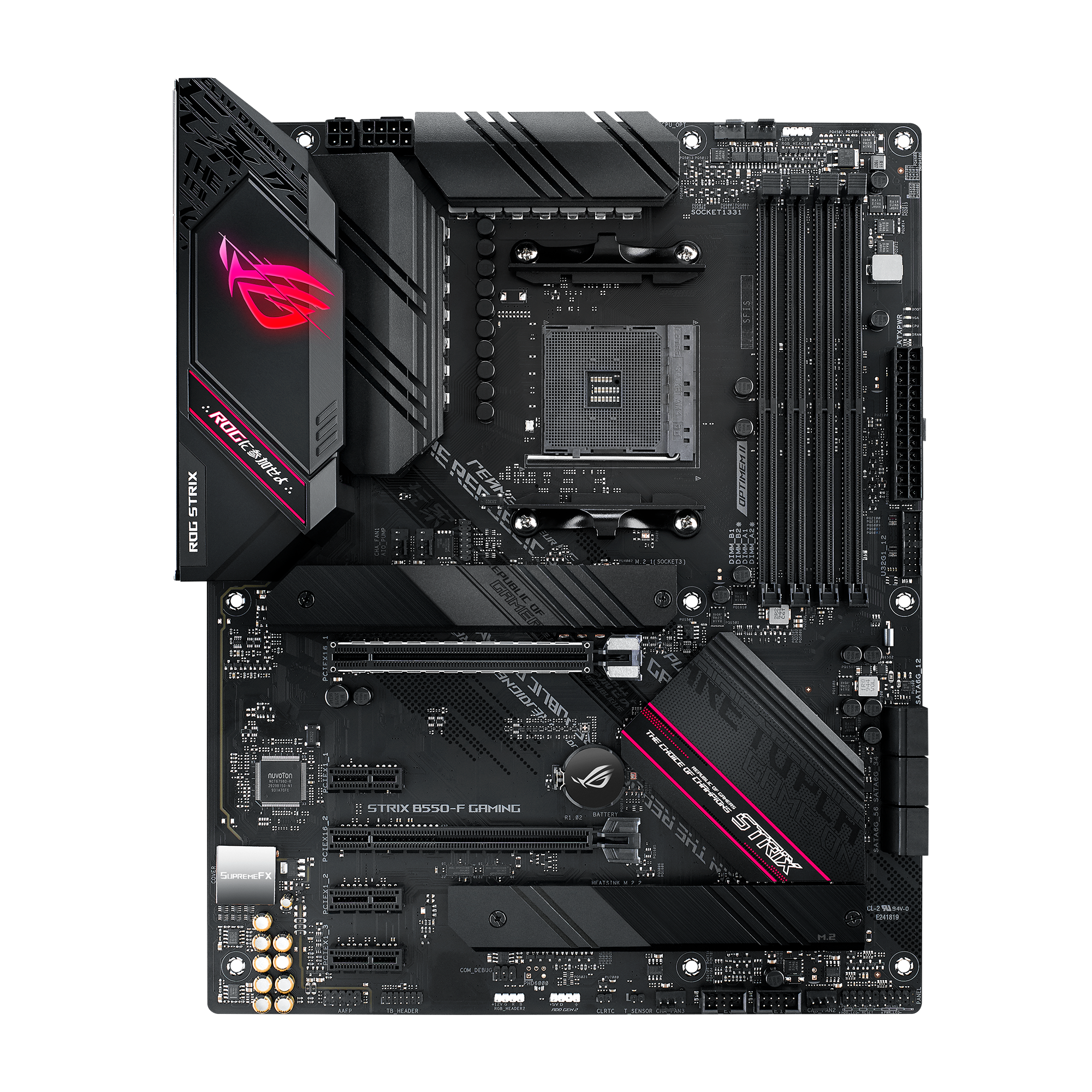

I have a system here -
Asus Strix B550-F Gaming Wi-Fi
AMD 7 3700X
32GB Corsair DDR4 RAM
NVIDIA 1660 GFX
Client had built system themselves and was working for a week or two. Then suddenly wont display - no signal.
So I checked
RAM
GFX
CPU
CABLING
ANOTHER PSU
This is where I thought the issue may be - BIOS Update for board. Though it was my understanding these two should be fine out of the box?
So anyway I updated the BIOS to no effect same thing all fans spin lights etc though no POST.
It has a Q-LED system on board as follows -
BOOT= NOTHING THIS IS WHERE IT SHOULD BE GREEN AND PROCEED
VGA = WHITE
CPU = RED
DRAM = ORANGE
So at the boot phase, it loops back through the Q-LEDS and never ends. So my thoughts are it must be a CPU >comm< to Board issue?
As I tried a different CPU a AMD 2700 in it and booted straight up, so the board is not an issue.
So frustratingly annoying..
