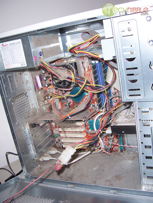

Thanks. They do have a nice setup but I would have wanted to see how it works with something like this. A bit more realistic on what a dirty computer looks like.
Looks like the last one I cleaned out... still cleaning up the mess that made :mad:
