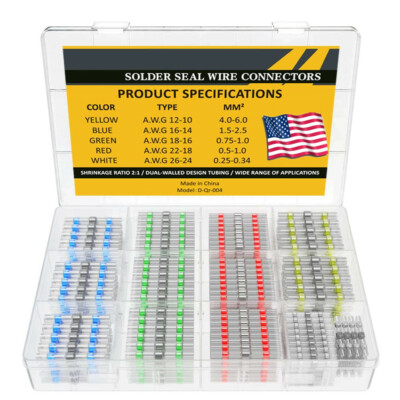

I tend to solder and heat-shrink all my connections as I've seen too many crimped connections fail after several/many years. The "new' thing now is the heat-shrink solder connectors without the need of an iron or solder. I've bought some but haven't really used them yet. (Still stuck in my solder and heat-shrink ways).
@Diggs
Does one use a heat gun, much like one does for paint stripping (but probably much smaller and more precise), to apply these things?
Definitely a very nice 2-in-1 setup if they work as advertised. The heat shrink wrap also acts as a bit of a stress relief, too.
Interesting product. I've never been a fan of low temp solders but I'm guessing that why there is the shrink tube and epoxy ring.
