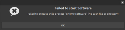

I am unable to open web/HTML links from Signal or Steam or other apps like Evolution.
Not sure when it started.
Clicking on a link brings up the "Open With" box which presents me with the message "No Apps Available" No apps installed that can open https://www.technibble.com (or any other URL.) Message continues with, "You can find more applications in Software."
There is a link at the bottom stating "Find More in Software." Clicking the button presents me with an error message "Failed to start Software" Failed to execute child process "gnome-software" (no such file or directory).
Trying to add Librewolf manually to the field in the Preferred Applications dialogue window fails as the field is not select able.
Thanks for any help.

@phaZed I tried the commands you posted which fixed the error message regarding "Failed to start Software."
The issue persists, however I am able to access the "Find More Software link."
Unfortunately it states "No Application Found"
