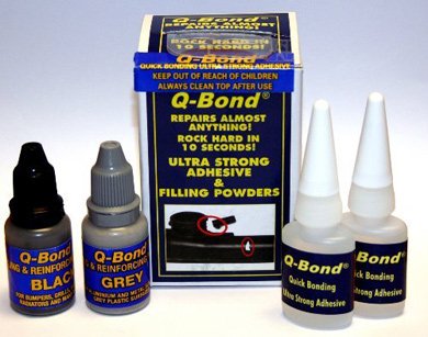

I use q-bond, its amassing. It sets in literally seconds and its hard enough to hit with a hammer and not break. You can file sand and shape it when your done. It sticks to metal, plastic, wood, and just about any other material you want to stick to. You can find it at a local auto parts store.
