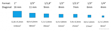

Some of the big things that are important with cameras (other than the resolution) is the sensor size and the lens.
For example, lots of people go straight for 4K cameras as "the best". Most consumer 4K's are pretty great during the day but suck at night.
My little 2MP with a large sensor will KILL a 4K at night.
My house has mostly 4MPs with a 1/1.8" sensor on it because its the best combo of daytime resolution and nighttime visibility. 4K isn't the best option for both.
Larger sensor, more light gets in.
Higher resolution, less light per pixel gets in the same size sensor.
Which is why my seemingly low-resolution 2MP 1/1.8" is awesome at night. Lots of light per pixel.
got it 👍 Now what do the numbers mean? is 1/2.8" bigger or smaller than 1/1.8" ?
I notice the reolink cameras
RLC-810 = 1/2.8" (4mm lens)
RLC-511 = 1/2.7" (2.7-12mm lens)
as a comparison, the Ubiquiti
G3 = 1/2.8" (3.6mm lens)
G4 = 1/1.8" (4.24-12.66mm lens)
