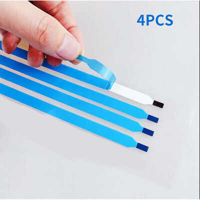

10PCS Laptop Screen Double-sided Adhesive Mobile Phone Easy-to-pull Display Tape Strip High-viscosity Bezel Sticker Glue Tape​
Got one of the screens that has a glue strip on either side with a little nub at the bottom for pulling out the strip just like the ones used to glue phones parts like an iPhone battery.
Am I able to buy this exact glue strip?
Otherwise, I have 2mm double-sided adhesive strips that I could use. I'd need to use 3-4 of them because they're so narrow. It probably wouldn't be as strong as the original tape.

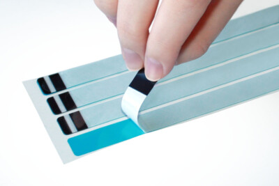

VHB tape is semi-permanent, you won't remove a screen without breaking it after using VHB. Better to just use TESA tape or red tape as it's more forgiving when trying to remove screens. The white tape battery tape works but it's much thinner than OEM stretch tape, still a better alternative than VHB, TESA and Red tape. About a year ago we ordered 100 pcs of OEM (or close) from Ali. It's the proper thickness so it adds some screen cushioning, it's stretch release without leaving any tape residue. I posted a link in here last year for a source. We really like that tape for screens.
