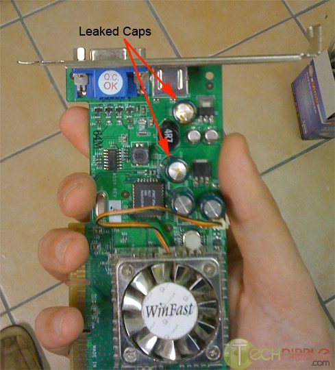

A few months ago I was called out to an on-site repair job and I was told that the computer could not boot into Windows. Once I arrive on-site, I powered up the computer and sure enough, the computer would not boot up into Windows. The system would go through the BIOS processes without a problem, show the Windows XP boot logo and then the screen would switch off.
If the display works fine out in BIOS but then switches off when the computer gets into Windows, this is obviously going to driver problem of some sort. So, I reboot into Safe Mode so I can do something about this driver problem and the screen switched off again when it got past the Windows XP bootup logo.
I figure that if I boot the system into VGA mode it should work and sure enough, it does. At this point I am suspecting that the video card driver has become corrupt or something so I download the latest video card drivers from the manufacturers official site, remove the old drivers and install the new ones. I rebooted the computer and the screen still switches off once it gets past the XP logo.
I am beginning to think that the clients screen may be faulty because it cant handle the higher resolutions. I go out to my car and bring in my old 15 inch LCD screen that I use for testing. I rebooted the computer again and the problem still exists even on my screen.
At this point I am running out of ideas of what this problem could be. I was sure it was a driver issue because the video card obviously works because it would work fine in BIOS. When a video card fails it either displays artifacts on the screen, locks up or just fails completely which wasn’t the case here. I take off the side of the case and take look at the video card anyway even though I still believe this is a driver issue.
This is what I found. (click here for the picture)
It seems those two caps had something to do with controlling the resolutions 800×600 and above. When the video card was displaying 640×480 out in BIOS I believe these two caps weren’t being used and therefor the video card would work fine.
When Windows got past the XP boot screen, it would switch to 800×600 or above, the information would go through these two damaged capacitors and no video would be passed to the screen which makes it switch off.
I replaced the video card with an identical one, powered up computer and it worked instantly. I didn’t even need to do anything with the drivers. I just goes to show you that the problem isn’t always what it seems. I can fix 99% of the computers that come my way and I was so sure it was a driver problem but the good ol’ world of computer repair decided to throw a curve ball my way and keep my ego in check.

    Bryce, you shoudn’t try to guess what capacitors do…
    The reason why the card doesn’t work at higher resolutions is because of the frequency of the signal going through the capacitors (higher pixel rate). The capacitors are always used in the circuit, they’re there to stabilize the signal, to remove noise. When damaged, they fail to do so at high frequencies first. They can also be used to stabilize the card’s power supply, and as the card draws more power at higher resolution, it fails as well.
    That said, this problem with bad caps started back in 2001 or 2002, when CPU frequencies got higher. We see mostly power supplies and motherboards with bad caps (Pentium4 era, mostly), and occasionally a VGA or some other card. Nowadays the industry is switching to solid capacitors that don’t suffer from this issue.
    Check out badcaps.net to learn something about this. There’s even a theory (proven?) about a stolen capacitor chemical formula that started all this.

    Those are power supply capacitors. They are also right next to the power regulators on that board. They’re electrolytic capacitors which are always used in power supplies and audio applications. Most likely the higher resolution mode required a purer DC signal and since the caps were faulty the gpu couldn’t operate due to ac ripple on the dc line.

  • To add to the above, leaky capacitors are often seen in older hardware. This was especially prevalent in the early to mid 2000s — there’s even a Wikipedia article about it — it was called the Capacitor Plague!
    http://en.wikipedia.org/wiki/Capacitor_plague
  • I had a similar problem about a month ago too. the caps on the video card were opened on the top which caused the same issue when booting into XP. It took me a while to figure out it would be a hardwae issue.
