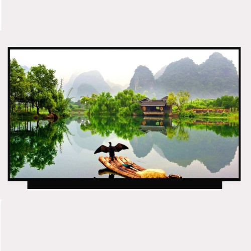

The only one I have found quickly is on eBay for about $160, shipped. From China, of course.
I'll be damned if I can find the Dell original part on their site. Not well designed when the support page with system specs & parts doesn't link directly to the replacement part purchase page.
@britechguy
I do not know if you have an issue with the seller I posted but I can endorse them fully.
That link to the actual screen wasn't there when I first read your prior message. The one for the tape was.
And I have no issue with the one you've posted. I need to look at how much shipping is, but other than that, I'm fine with the price, as it seems competitive.

We use those folks a lot for screens - We've always been happy with their service, packing & fast shipping. Also, once you establish a history with them, there is an unpublished discount that gets applied on the final purchase, not earth-shattering, but nice anyway.
