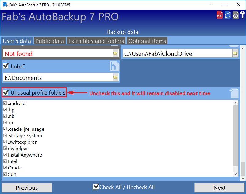

Here is my proposal:
- The program will look at C drive's root for unusual folders and select them if there are some. There could be some unwanted folders but that's another concern that will be treated later. Same thing for unusual folders in the user profile's root. The feature is under development.
- There WILL be a feature for default backup/transfer profiles. This one has not been started yet due to the amount of work required (there are instructions to put almost everywhere in the program, at least one per supported item, so, you can easily imagine the programming nightmare behind this). They will be selected using a dropdown menu (I still do not know where I will put it but that's my problem, not yours). And, like I was supposing, some of you would want to have it selected automatically. For this, there will be an additional "use this profile by default" check box that will show a warning about potential data left behind. This way, I AM totally covered if the tech misses something because of that default profile. In fact, everything will be unselected by default, except the items specified in the profile. It means that if a new supported item is added to Fab's AutoBackup, it will stay unchecked for whoever is using a backup/transfer preset until they manually add it.
I hope that statement will satisfy everyone an stop this polemic.

I understand what you mean. The whole "unusual folders" items will have its own check box (one for the user profile, the other in the "public" tab) and checking it or not will be remembered like for the additional folders item.
This way, if you choose to uncheck both, it will still work as before the change ;)

If you are using the extra files and folders for the same purpose, then yes, there can be duplicates in the backup.
By default, all the non standard detected items are listed and checked. It means that if you have checked the same in the extra folders, it will be better to choose which item you want to use. If you wan to stick with the way you do it today, just clear the Unusual profiles folders general check box (and the Unusual C folders) and keep using the extra files and folders like you are already doing.
That right there is going to generate plenty of confusion and creates the potential for mistakes.
Which user profile? Remember earlier there's the "Select users" checkboxes where I select which user profiles to backup. After Next, the "User's data" tab selects items for *all selected user profiles*. So when it comes to "Unusual folders" is it now displaying unusual folders found in all of the selected profiles?
Why? Isn't it *unusual* because it's... well.. not usual?
The paradigm is getting muddied. Up to now, the "User's data" tab is selecting things that are common to all profiles. Now you're adding to that things that are not common but specific to one profile on one computer and it doesn't show which profile and you want to remember it for subsequent computers.
Surely "Unusual folders" is already covered in "Extra files and folders"?

Edit: Here's a thought: On the "Extra files and folders" page, place a button that will "Scan for unusual profile files and folders" and anything found will be added to the "Additional Folders" tree or "Additional Files" list on this page and automatically checked. From there on the backup and restore is handled by existing code. You're work is done! Minimal changes to the gui, no change to the "just do it" use case, re-use existing code. Everyone wins!
