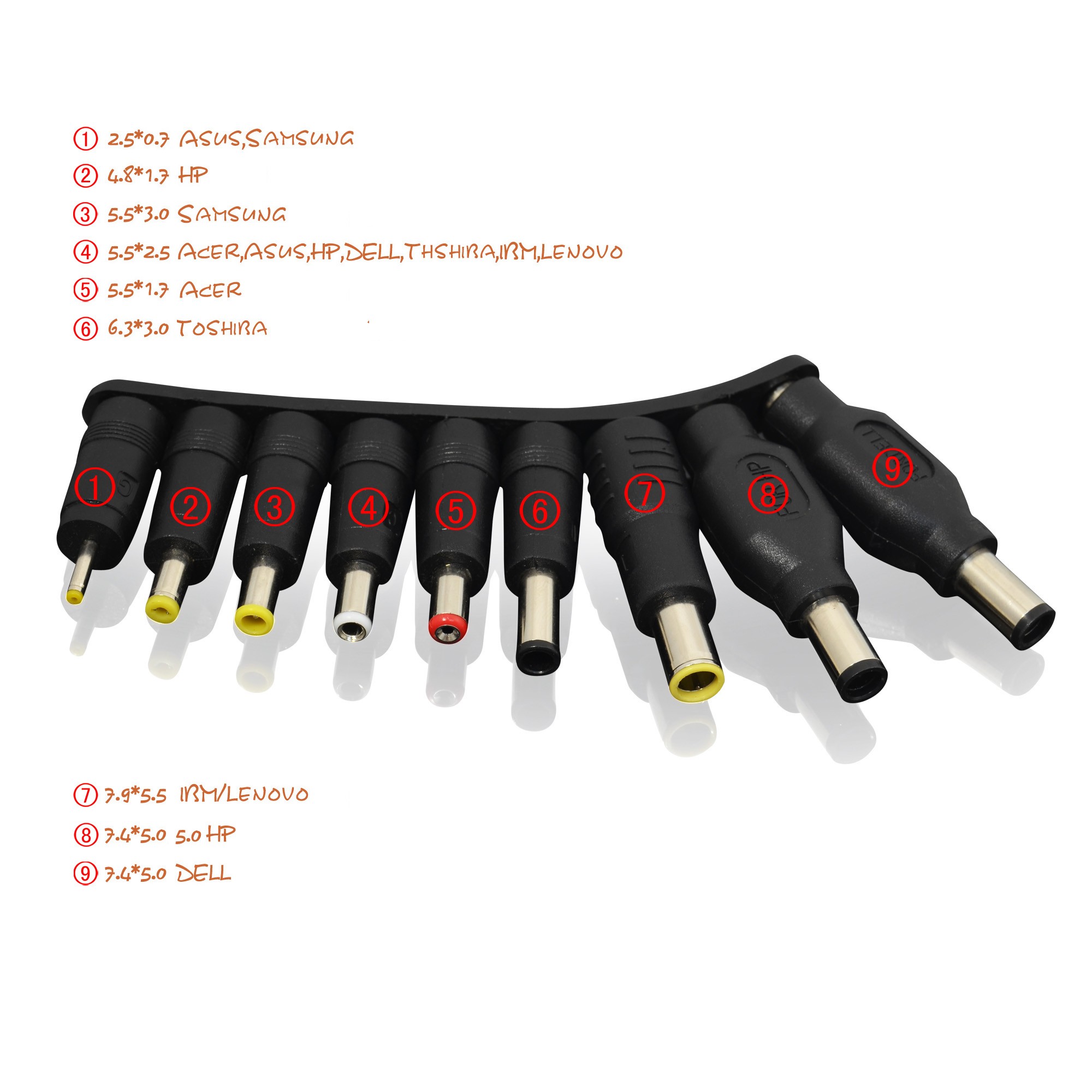

The chip is in the connector tip. This is my adapter and items 8 & 9 are the tips.
