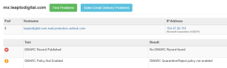

Funnily enough, when the support team responded to our support request (I was CC'd in it) their response went to my Junkmail folder. I looked their domain up for anything blacklisted at MXtoolbox but they aren't black listed either.

No DMARC, perhaps there's not even any DKIM in place. Should have all 3.
Well DMARC isn't SPF or DKIM.
