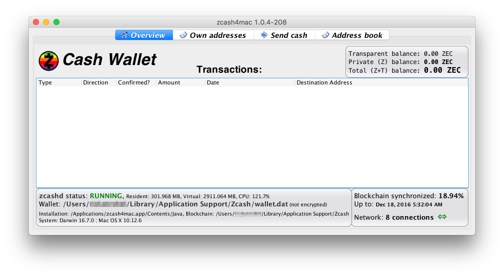

OK, so I'm trying this now. I got the EWBF miner and installed the Mac wallet app.
I downloaded the Mac wallet app for Zcash because it seemed like the easiest way to get started. However, I'm not really sure I understand what I've got. With Bitcoin I've got a couple of addresses. I don't run any software to have those. They just exist. I've got the public address and the private key for each - they're just strings of text.
But now for Zcash I've got this app running on my computer. Once I installed it I had a Zcash address.
A few questions:
  1. Does this program need to be running when I get my payments from the pool? (I don't think so, I think it just reads the data from the blockchain to figure out my balance)
  2. Speaking of the blockchain... Will my Mac have a full copy of the Zcash blockchain? It's 18.94% synchronized in the screenshot.
  3. Can I extract the private key from a data file somewhere if I don't want to rely on the wallet?
Usually these types of wallets require you download the block chain. If you don't want this then you can try a light client (much like Mycelium for BTC) which I run on Android and it doesn't require full synchronization.
The wallet doesn't need to be open, it will sync with the block chain and get your funds.

@timeshifter I'm not familiar with that wallet (or Macs) but it looks like a 'full-node' wallet. If you don't mind waiting for blockchain synchronisation each time you open it, a full-node wallet is the best type of wallet to use. In addition to holding your private keys, a full-node wallet downloads and verifies the entire blockchain, meaning that you do not need to 'trust' any other network node. It also means that you're helping to run the network. As NviGate says, you could try a 'light' wallet if you don't want to have to wait each time. I use both types of wallets for any cryptocurrencies that I own larger amounts of: A full node wallet (in a VM that I keep offline most of the time) for the majority of the funds and a light wallet for smaller amounts. You can think of a full-node wallet like a bank account (somewhere to store the majority of your funds) and light wallet like a real physical wallet. In that respect, it would be wise to hold no more funds in a light wallet than you would a real wallet, especially if you're going to carry it with you on a mobile device.
With most wallets, there's usually some sort of private key and/or wallet file that you can copy and backup. Many wallets are 'deterministic' and use a 'seed' (in the form of a dozen or so random words) to generate a unique private key. The private key is then in turn used to generate numerous public addresses. With these type of wallets, as long as you have the seed you can regenerate your private key from it.
In all cases, your funds are just data on the network. A wallet simply allows you to view that data and the private key proves ownership, allowing you to request new entries into the blockchain ledger that result in the transfer of funds. So, nope, you do need to have any wallet open to receive funds.
@Moltuae thanks for that explanation, that helps.
I did find a menu option to export keys. Also now that the blockchain is 100% synchronized. I checked the folder size: 5.9GB :D
