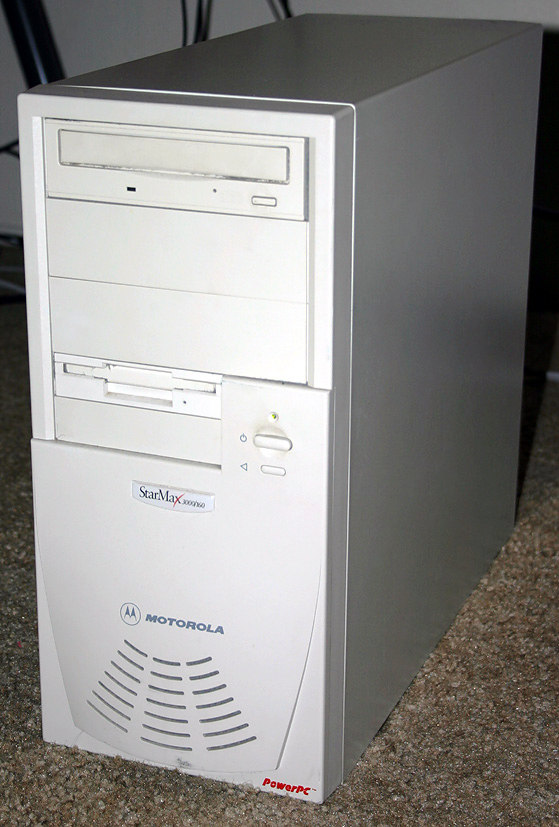

Hey, anyone remember the third party Apple computers? That was a good time. I should look to see if that actually helped Apple's marketshare or hindered.
I don't think they really amounted to much. Remember that Apple is a hardware and software company. They licensed the OS's to other who built their own hardware. They did not use Apple parts that I'm aware of.
